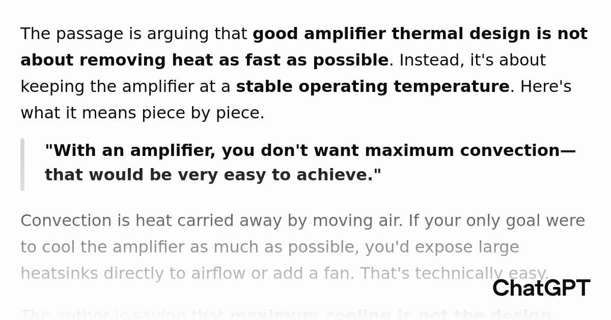

Sorry, that doesn't make sense. You're overlooking why Topping chose this cooling design and why it is so optimal, especially for this specific amplifier.
Of course, it is incredibly easy and cheap to implement cooling based on direct convection using a finned heatsink. However, the "more is better" approach is actually counterproductive to the amplifier electronics' performance.
There is a vast difference between maximum convection—often found in cheap amplifiers simply because it is a low-cost, simple solution—and indirect convection precisely tailored to the specific use case. The latter is significantly more expensive to develop and test until it is optimized.
There are many small pieces of the puzzle that enable the Mini 300, PA5(II), and 3E Audio A5/A7 to achieve the best measurement results and performance among TPA3251/55-based amplifiers.

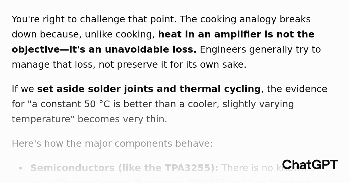

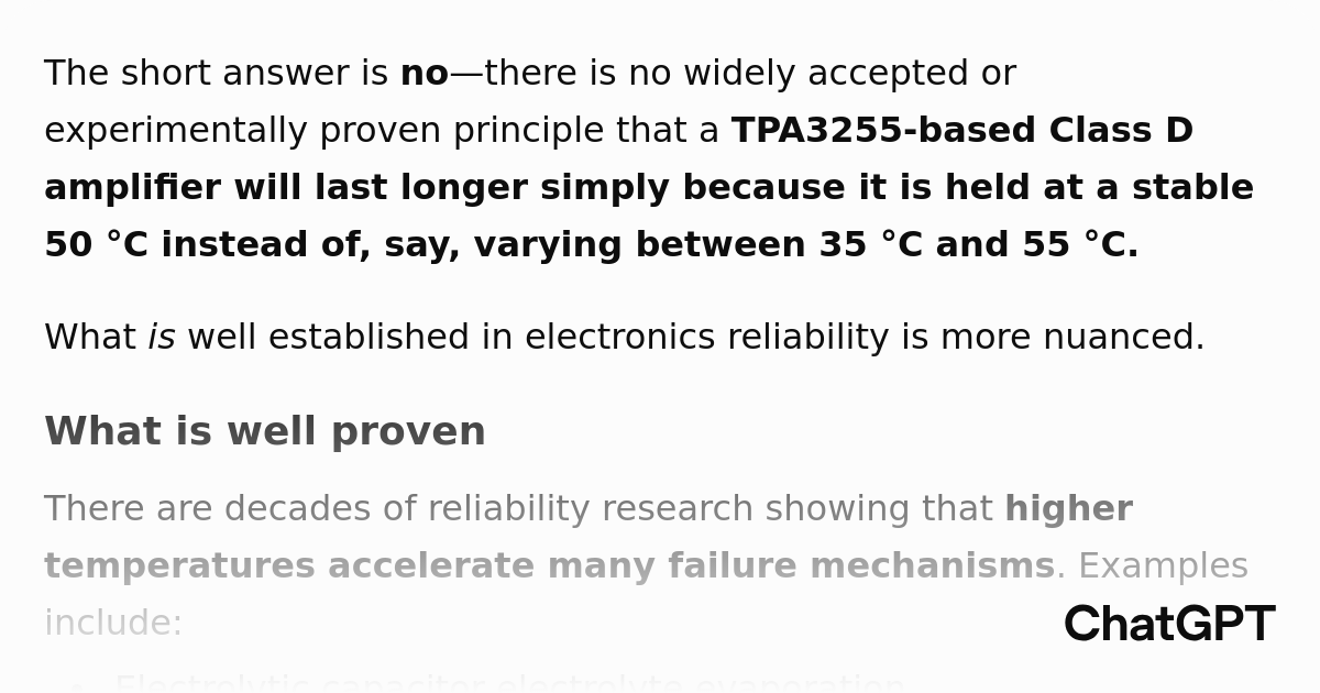

I do sincerely appreciate your write-up here, it forced me to read up some stuff to understand what you're saying. And what you're saying is, ambient temps don't matter in the grand scheme of things compared to the heat from the operation of the components themselves?
I gave it some thought, and I think it comes down to these points:
1. You see the temps and say, sure, they're as expected. But the crucial point is, you're talking from the pov of an expert who can troubleshoot and repair the amps yourself if they break.
2. Yes, you cited 28 years which looks like a pretty number. So I did what any non-expert will do. I asked Google/AI:
"Calculate lifetime of 85c rated electrolytic capacitor at 30°C vs 40°C ambient temperature"
They gave some answers and some links (I linked one of them below):
3. I do have the mini 300. I have it on for at least 12-14 hours daily, hooked to my pc which I use for mostly work (ahem!) and some play, AT LEAST 5 days a week. Room temps generally 27°C but does go up a little. So conservative estimates say my amp is on 12 hrs x 260 days (5-day wk) = 3120 hrs / year. And I do consume media for say, 30-40% of those hours.
4. Of course, there're also other experts like this gentleman, who sounds sensible:
I respect your opinion and thank you for your feedback. What you have just said backs up what I said - although the silicon itself is reliable, it is everything else in the ecosystem that will kill your circuit as a result of high temperature. The point I am making is that temperature will not kill the silicon. However, increased temperature causes other problems (increased mechanical stress etc) and it is these factors that kill the circuit not the silicon.
I agree that most circuit die through EOS (electrical over stress), but this is a different failure mechanism completely. This post is related to temperature and its effect on the lifetime of a circuit, not electrical overstress
5. My other frame of reference for tiny amps, is the SMSL SA300, which I now realised uses a 24V 6A brick. So when I got the mini 300 I was definitely surprised the chassis's way hotter than my previous amps. Amp's not playing audio but it's warm and consuming about 7W on standby (with my wall plug meter). Of course my next thought is 'Wow, Class D is supposed to be efficient, so why the heat? Is it going to kill the amp sooner?' I checked online. Indeed there're other concerned owners.
6. So gathering all the above data points as a non-expert, my key takeaways did not change too much and is probably aligned with the gentleman at point 4 (and probably with those bros who added vent holes to their amps as well):

I asked chatgpt to explain your statement, not to continue the 'fight' with you, but my basic science education doesn't quite grasp what you're saying. This is the reply I received (shared as a link to avoid wall of text):
My next question was:
has there been any accepted or proven 'truths' that class d audio components like the tpa3255 circuitry last longer with thermal stability at say, 50 degrees celsius?
And chatgpt's reply:
Finally, I felt the analogy chatgpt gave was not quite right:
your answer doesn't make any sense. compared to cooking, heat in modern amplifiers is a by-product isn't it? what evidence is there that a 50 degree enclosure is better, disregarding the physical properties of solder joints?
Designing products to a budget constraint makes total sense to me, because as I said earlier, economics!
And yes, I get that chatgpt is a 'mere' aggregator of stolen online information, but still, it did not agree that a 45-50 degree 'constant-temp' enclosure is good for audio electronics in today's products. And since Amir's graph has already shown that there's no performance difference at start up vs running the amp for a while, then there's no need to keep audio components 'warm' for 'best performance'.
