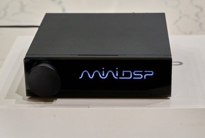

I actually ordered two, with the intent of using them for active speakers, but will return one as I can't really afford an appropriate DSP unit. I need a low latency unit with balanced ins and robust control and that's basically just the minidsp flex which is wrecked by tariffs. These amps seems good for that as the self noise is basically non-existent.
I do wish the gain was higher, my aiyima A07 amp seems to have it much higher so I can get more volume out of the amp, but it also scares me because the amp is 'hot' signal wise. It also likes to spark if the leads touch, or touch any part of the chassis.
...but will return one as I can't really afford an appropriate DSP unit. I need a low latency unit with balanced ins and robust control and that's basically just the minidsp flex which is wrecked by tariffs...
Move quickly!
Current bid $355 and ends in under four hours!
