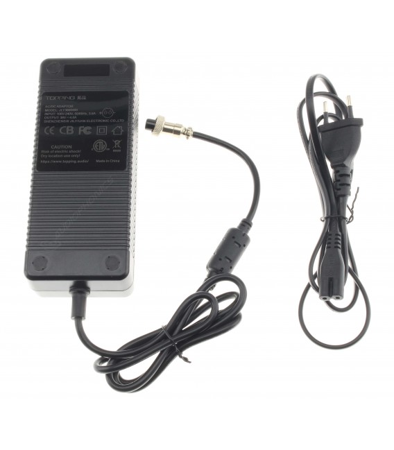

We can assume it's a TPA3251 since the PSU is rated at 38VDC/4A
The PA5 II is rated @ 38VDC/3.2A so you can compare.
Good luck finding a replacement for that oddball 38V power brick with the GX12 connector when it goes poof.
You could say the same thing about the Topping PA5.
€27 for a replacement.
Can I use the power supply that came with my 'game-changing' Topping PA5 ? ;)
You can clip off the cable and splice it to a suitable garden variety power brick and you're golden. If you don't want to butcher the replacement power brick with a splice, you can even use a screw-terminal female barrel connector attached to the clipped off cable end, making it into a barrel-to-GX12 adapter for a no-soldering DIY solution. 5.5/2.5mm barrel connectors are generally rated for at least 50VDC and plenty of current, so there's apparently no issue there.
Why not if it matches the power and connectivity?

Clip off the cable and splice it to a suitable garden variety power brick and you're golden. If you don't want to butcher the replacement power brick with a splice, you can even use a screw-terminal female barrel connector attached to the clipped off cable end, making it into a barrel-to-GX12 adapter for a no-soldering DIY solution. Barrel connectors are generally rated for at least 50VDC and plenty of current, so there's apparently no issue there.
There are JackDC to GX12 adapters available without any hassle... You might as well just buy the whole PSU for €26
