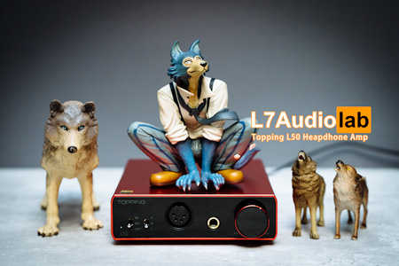

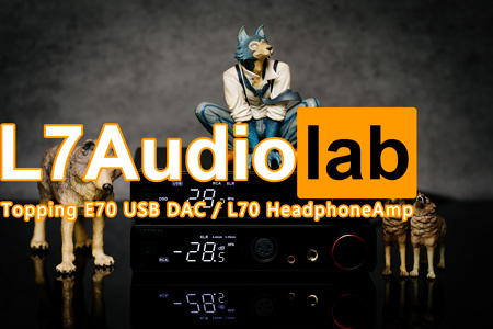

SNR@50mV
ASR --------------------- L50 ( 95 dB) > L70 (93 dB)
L7Auidolab-------------- L70 ( 97 dB) > L50 (95 dB)
Variations by unit?
Can anyone provide clarification on this?
SNR@50mV
Variations by unit?
Different devices, different measuring instruments, different people performing the measurements, different deviations, different contact resistances of the measuring cables, etc.
This is still within the range of measurement inaccuracy and other deviations.
The L70 on ASR was also closer to 93.5-93.7.
But you do realize that these differences are completely inaudible? And that you would have absolutely no chance of distinguishing them by ear?

L7 uses the APx555's high performance mode whereas Amir doesn't for consistency reasons.
No matter which DUT, if measured by L7 you'll often see 2dB less noise than on ASR.
So the reason is not DUT unit variation, but differences in measurement setup.
