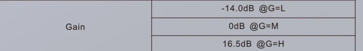

You can use a basic multimeter to make sure that the defect actually lies with the L30II.
For this use REW or an online tone generator to play a 60Hz test tone.
First, plug the L30II out of your DAC, then measure the DACs output voltage by probing the RCA cable:
Then without changing volume, plug your L30II back in, unplug your headphones but leave the headphone cable plugged into the Amp, turn the volume knob all the way up and use the other cable end to measure the L30II output voltage.
If you don't have a headphone or IEM with removable cable, then you can buy a headphone solder plug or breakout board for ~$2.
Measure the output voltage in all three gain settings and you can calculate the gain using 20*log10(L30II output voltage / DAC output voltage).
You can then compare against Topping's official figures:
If there's significant deviation, then it'll be easy to communicate and demand replacement from customer service.
