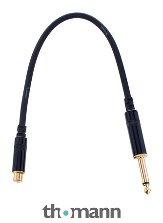

What cables for coming out of something like an RME Fireface and into the L30ii? TRS to RCA...anyone have a suggestion/ link for what to get? Thanks
If we're talking about a Fireface 400 or Fireface UC, the TRS outputs are "servosymmetric". This means, the inverting signal must be shorted to ground and the non-inverted signal will then have the full amplitude (note that this does not hold for the XLR outputs of RME interfaces and is not a general feature for TRS outputs of other interfaces).
The "mono" TRS - so actually TS - shorts the inverting output to sleeve and this is the right cable for you.
Something like this:
Maybe you can find a cable TS(male) - RCA(male) if this is more convenient.
If you say which Fireface you have I can look up if it really has a servosymmetric output stage.
It's actually well described in the manual how the wiring needs to be.
