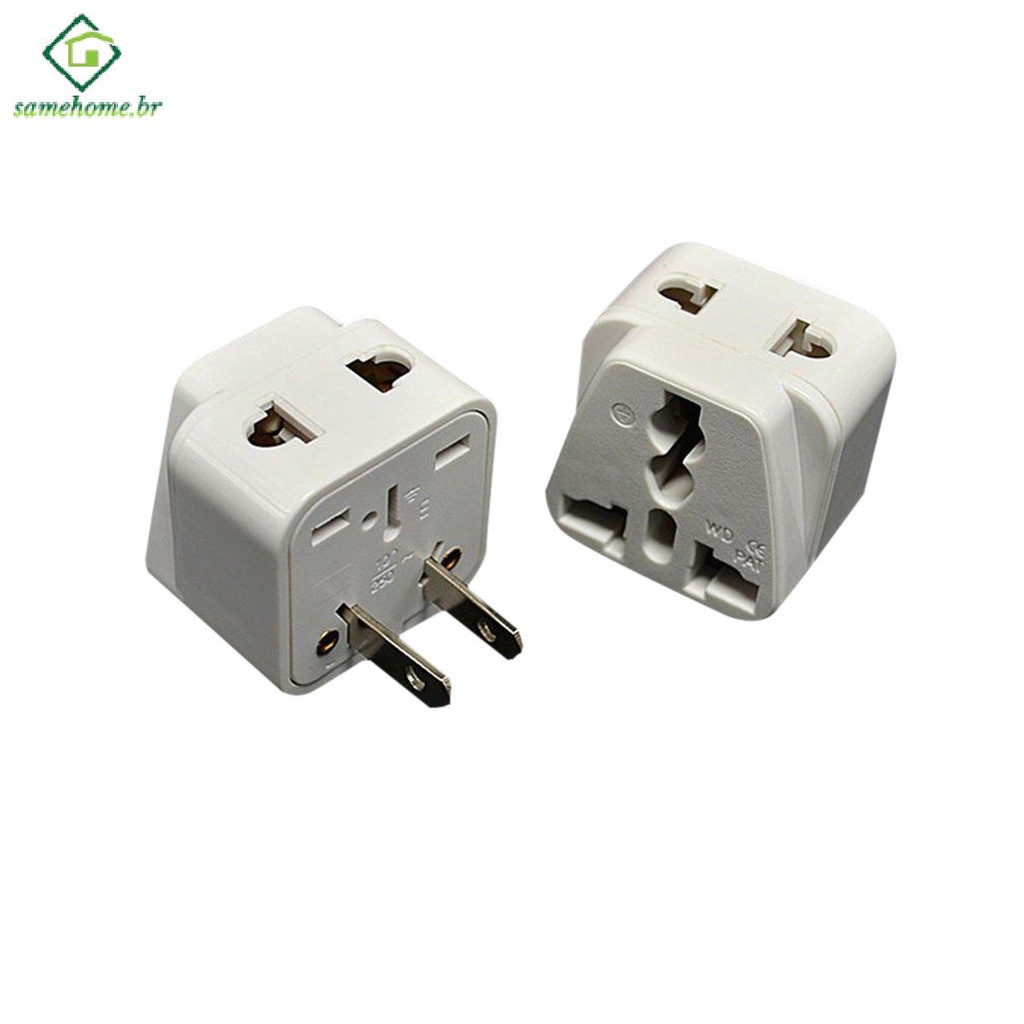

This DAC has a ground pin. That's nice! But you have a pc and a balanced DAC connected to ground feeding a unbalanced and not grounded amplifier this might being causing a ground loop which is leaking to the L30. It isn't the safest approach to test it but if you have a power plug adapter without the ground pin you could leave the dac floating (it will remain grounded only by its USB connection) and check if the interference stops. In the case of it stops, I would recommend you to buy a USB isolator like the Topping HS01 or something similar or buy a balanced headphone amp.
Usually low votlage unbalanced devices with external power adapter has no ground in their power input - L30, E30, Sabaj A10h, A10d etc. The manufacturer expects the user to connect it in a grounded source device like a desktop or noebook. But some times the expected implementation is a little different from the user intention. I'm not saying you are wrong.
power plug adapter:
