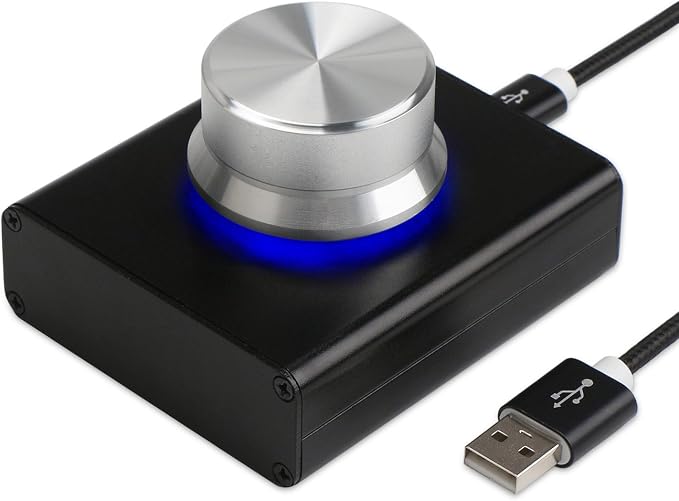

I've recently got a power amp (vintage Denon POA-800), and tried using my Asgard 3 as a preamp (with E30 as source). While I enjoyed using a volume knob, I couldnt get past 9-10 o'clock without speakers getting too loud. POA-800 has 1V sensitivity so I assume Asgard preamp output voltage is quite high at low gain.
So I tried using E30 as a preamp (using a splitter to daisy-chain my power amp and Asgard so I can listen to speakers and headphones independently). Now I get much more volume play (-45 to -50 is a good low/moderate listening volume and I never need to go beyond -25). However I really want a volume knob of some sort. Was considering either L30 as preamp, or switching my E30 to a DX3 Pro (which doesn't measure as well as E30) or Loxjie D30 (which does measure better than E30).
However my concern is whether the L30 will colour my speaker sound. I (subjectively) feel like I got clearer and my dynamic sound when I used my E30 as a preamp and really like the sound. Does this observation even make sense?
The way I see it:
Pros of getting L30:
1) @JohnYang1997 has mentioned better SNR at low listening levels
2) Nice physical volume knob
3) I get a high-performance headphone amp, who knows I may like the sound better than my Asgard 3 and could sell my A3
4) Cheaper (£120) than getting either a DX3 Pro (£160) or D30 (£132) and so is the cheapest option for a non-passive volume knob which I can integrate into my system
5) I get a dedicated switch to select preamp which makes the system more idiot proof and prevents me from easily blowing out my speakers
Cons:
1) Extra component on desk, need extra power socket, which I have limited number of despite having two power strips
2) Adding extra component to (speaker) signal chain, unclear how that will affect my sound
3) I forego extra features such as bluetooth
Thoughts? Am I just overthinking this?
