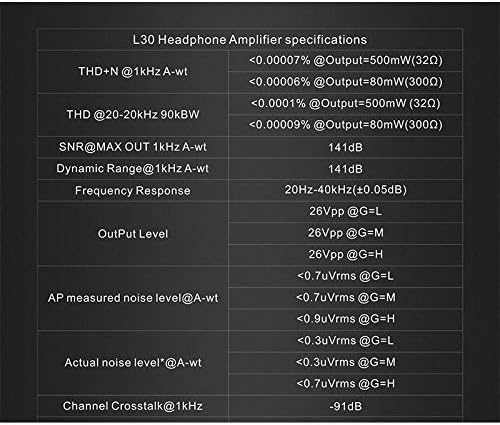

Topping L30 Headphone Amplifier Review
Wow, nice!
Can it handle 16 ohm load? How much power at 16 Ohm?
Any thump, pop or crack at startup, shutdown, or loss of power?
3.5W 16ohm dual channel driven.
No pop on startup and shutdown.
The indicator LED is gentle and warm white color that's visible at all angles.

Is L30 DC-coupled? I see some relays, only power-on delay or maybe there is DC protection too?
L30 doesn't show that behaviour.
AC coupled using a large electrolytic cap. Has DC protection implemented. Low frequency distortion is still under 0.00003% (4 zeros after decimal point).
