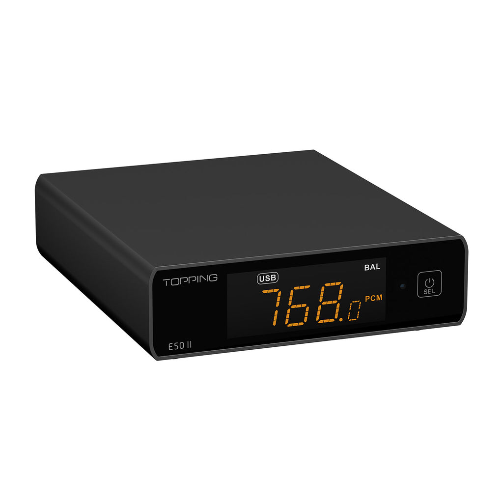

Topping E50 II DAC is up on the Topping Store
