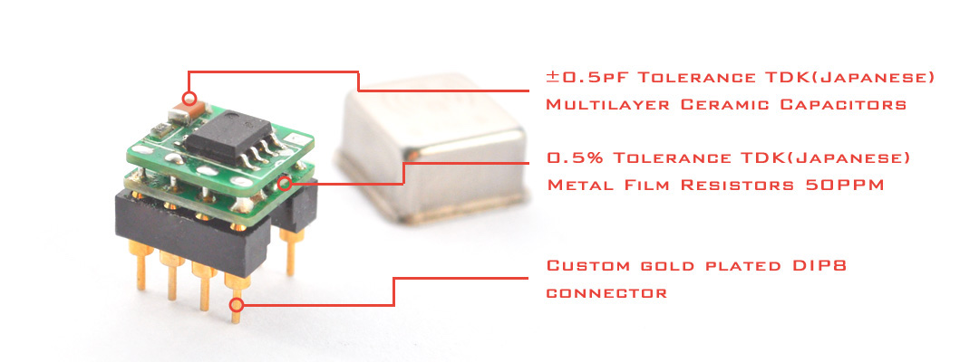

How does it compare to the D10. I threw a busron V5i-D in my D10 and it's excellent. I sometimes wonder if those opamps have two singles inside.
I had the D10. Even with a V5i opamp. In the end, I chose the E30 because it sounds more spacious. More stage and details.

The burson opens it up a little. I've had awful luck using them in pairs in a few amps as depending on the gain a static noise would be present no matter the volume.
There are a few standout set soic opamps, I'll bet that the burson is something like this two singles on an adapter or a single soic with some extra components. The V5I that is and the rest of them are the discrete in house designs.
