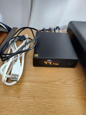

Can someone explain how that fixes the issue? Changing between A-C and A-O doesn't seem to make any difference.E30 also does what you need.(edited) I have a power strip. When powered on, everything turns on... except the E30 which goes into standby mode and requires a button press to activate.
You have to set it by accessing the A-C or A-O options available in the start menu, accessible by keeping pushed the front capacitive button of the E30 during the power-up.
I am having the same problem — my E30 (AK4493 version from 2020, FW v1.08) is powered by a 5V adapter plugged into a power strip that controls my AV rack. When I power on the AV rack in the morning, the E30 stays in stand-by mode even though my laptop is already powered on and connected to the E30. And it continues to stay in standby mode if the laptop is audio to the E30.
As a test, I set my laptop playing a song. Then power cycle the E30. After E30 is back on, the device is fully visible to the PC's Device Manager and the Topping USB Audio Control panel; but it remains in standby instead of music again being sent through to my mixer / amp.
I want the E30 to immediately go active if the USB connection is active. This happens for the D90 but not the E30.
