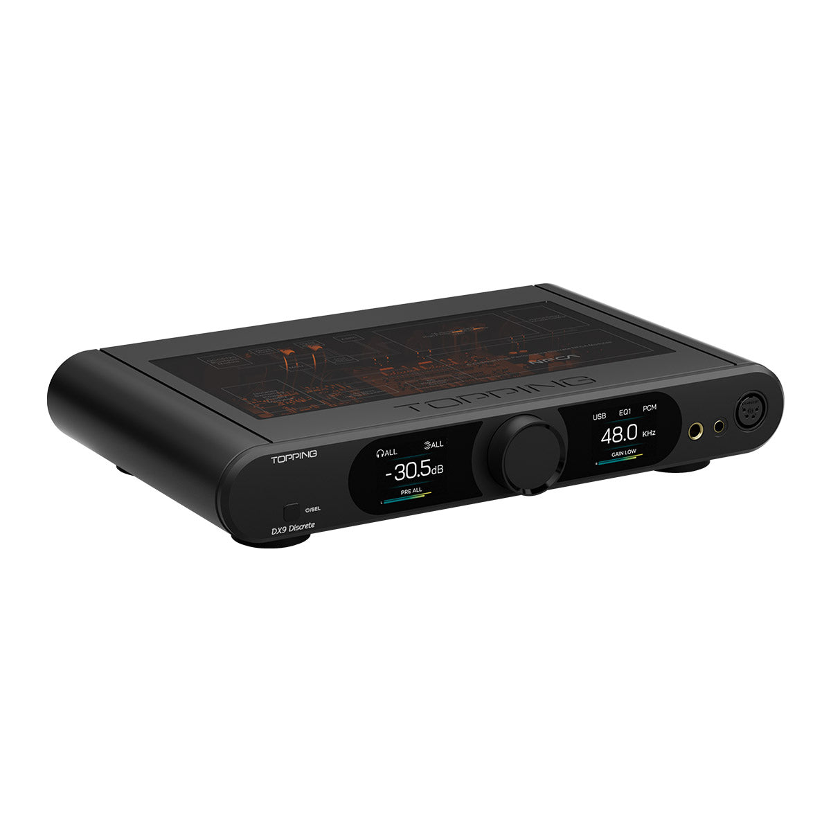

Topping has just released the Topping DX9 Discrete, its a non-Delta Sigma dac or R2R (though this seems like a fancy R2R from my layman's pov) and I just have to wonder, what's the point? Haven't we reached the point of diminishing returns with these specs? Don't get me wrong, from a technology enthusiast standpoint, its cool to have something that's different but outside of it being different are there any benefits to a product like this?

The DX9 is a device for people looking for a high-quality device with as few compromises as possible, regardless of whether this offers any sonic advantages.
Since the limited supply of old AK4499EQ chips was exhausted, but demand for such a device continued, Topping is now continuing this device as a Discrete DAC.
The DX9 Discrete is overall a very independent design and development with a few differences from many other DACs with integrated HPA.
- Balance and crossfeed function
- Completely separate and sophisticated power supplies for the digital and analog sections, effectively providing three different and separate voltages
- AK4118 transceiver chip, by far the most compatible solution for SPDIF/Toslink/AES
- Analog and relay-based volume control for the DAC and HPA
- Extremely powerful HPA with peak-range measurements
- Completely separate headphone amplifier for SE and Balanced modes with 6 instead of 4 power amplifiers, with completely separate circuits for SE and Balanced modes
- Large enclosure, allowing for a relatively separate setup of the different sections
