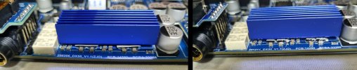

Hey everyone,
The last time I posted here, I mentioned that my DX5 II suddenly died after just 7 months of use. I wasn't able to send it back to China because the postal service in my country is terrible, so the seller ended up sending me a replacement PCB for me to install myself. I replaced it, and the unit is now working properly with my speakers.
What caught my attention is that the replacement board is clearly a newer hardware revision. The main PCB went from v1.1 to v1.7, and the 4.4 mm output PCB is now marked as v1.2.Does anyone know what hardware changes were actually made?
I asked Topping what they had modified and whether it was now safe to use my headphones. They didn't provide any technical details—they just told me not to worry and to avoid hot-swapping headphones.
Has the root cause of the 4.4 mm output issue ever been identified? Are people still experiencing these failures today?
To be honest, I still haven't had the courage to plug my headphones into it. I've read comments from people recommending a 4.4 mm-to-XLR adapter to avoid using the 4.4 mm output altogether, while others claim they've experienced similar issues even with the XLR output.
So what's the current consensus? Is the DX5 II finally considered reliable, or would you sell it and move on to a different device?

Hey everyone,
Mine died after 7 months also. I got a refund from the seller. As I have no idea what's wrong with all of these DX5 II's failing, I got myself a DX1 II instead (less money = less risk).
Because the seller said I could keep the brick, I'm using the dead DX5 II as a learning bench and trying to figure out what is wrong with it while learning some electronics.
I requested a refund, but the seller (ShenzhenAudio) refused. They said I would have to return the defective unit in order to get a refund. The problem was that shipping it back would have cost me more than $150 USD, which made no sense considering I paid $230 USD for it.
I hope you're able to find out what caused the failure. I don't know much about electronics, but my guess is that the internal power supply may have failed.
Mine was also Shenzenaudio. But I bought it on Amazon, with shipment fulfilled by Amazon. Here in Germany, the seller is obliged to provide a refund or a repair, with shipping costs on them. So in my case, because shipping costs to China are high, they just told me to keep the brick and refunded me the full €299.
There's no real reason to be that fearful.
As long as you're not plugging/unplugging while there's content playing (which you shouldn't really do anyway), the chances of things happening are quite low. Also, it looks like the HW revision was specific to the 4.4mm connector since the connector/board is different, so it's likely they've addressed the issue.
