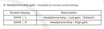

But does it have a gain adjustment?
See the product page
