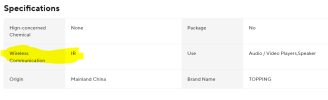

I just sold my unit. Used for maybe 5 hours. Didn't use the remote. The buyer just sent me a message that the remote is 't working. Is there a special way to make this work? It is in dac mode now, he didnt reset the unit.
Edit some grammar. The buyer of course.
I just sold my unit. Used for maybe 5 hours. Didn't use the remote. The seller just sent me a message that the remote is 't working. Is there a special way to make this work? It is in dac mode now, he didnt reset the unit.
Is there a battery in the remote?
Yeah, but he is not sure that they are full ones. Tomorrow, he will place new batteries. He did test with his phone. The remote is blinking.
I would check to see if Bluetooth is enabled in the settings.
I did advise him that. Then I've read it is a ir remote. I thought rf remote probably. I know bluetooth is off now. So, it is a bluetooth remote? That's the simple solution then.
I think it's a Bluetooth remote, but it might have both IR and BT functionality. A cursory search didn't yield much, if any, information. The RC-15A definitely notes it's a 2.4gHz BT remote in the devices that have that remote, but nothing on the RC-16A.
IR only.
(link)
Thank you for thinking with me on this problem.The remote is a RC-18A. He will try tomorrow with bluetooth on and or a reset.
Thats the answer! Now this old fool remember. I did turn that off to secure unwanted volume with a remote. Muchas gracias!
