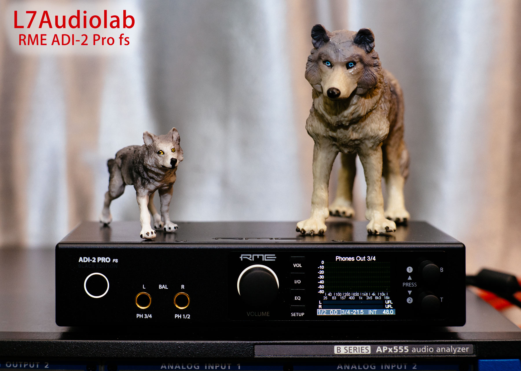

That’s because the RME has harmonic distortion (odd harmonics to be precise) which makes it sound “fuller” changing also perception in the rest of the auditory range (you can find the measurements on the site). Technically speaking what you hear on the Topping is more faithful to the source, but if you like a more colored sound for listening then dac/amps with different blends of harmonic distortion like the chord ones can be your friends rather than more analytical ones.
That’s because the RME has harmonic distortion (odd harmonics to be precise) in the range 2kHz- 8kHz which makes it sound “fuller” changing also perception in the rest of the auditory range (you can find the measurements on the site). Technically speaking what you hear on the Topping is more faithful to the source, but if you like a more colored sound for listening then dac/amps with different blends of harmonic distortion like the chord ones can be your friends rather than more analytical ones.
It what???
Where did you see that?
All the measurements I have seen of ADI-2 pro have their THD+N at about -108dB at this freq range, a little worst than the ADI-2 DAC.

It what???
Edit:example:
Did you see the level or just read the text?
orange line is mine:
RME ADI-2 DAC vs ADI-2 Pro 1 kHz noise and distortion Measurement Comparison.png
The "more harmonic distortion" comment here, refers to the -122dB and -130dB spikes at H3 and H5 and is purely technical about the comparison.
Yes, but that's the measurement for a simple 1 kHz test tone wave, now throw a song on it and add not only 1 kHz but all the rest of the spectrum and see what happens, that -120 shoots up, we're not talking louder than the main tones of course, but they compound and the sound starts to push forward. It becomes audible to an experience listener. Don't think like is some atrocious thing, simply it gives a slight color. Most of expensive mic preamps have as main selling point the blend of harmonic distortion they add, which get used on instrument/genre/preference basis. That's also a (noisier) way to boost signal level.
Personally I still think listeners should leave coloration to the music creation side and aim at highest fidelity possible, but at the end of the day the audiophile world is famous for expensive tubes and all sorts of creative ways to add harmonic distortion and each person likes a given kind of saturation and choose equipment based on that tone. The goal for example of good mix and mastering engineers is among other things to make a song translate as good as possible in any device and situation.
