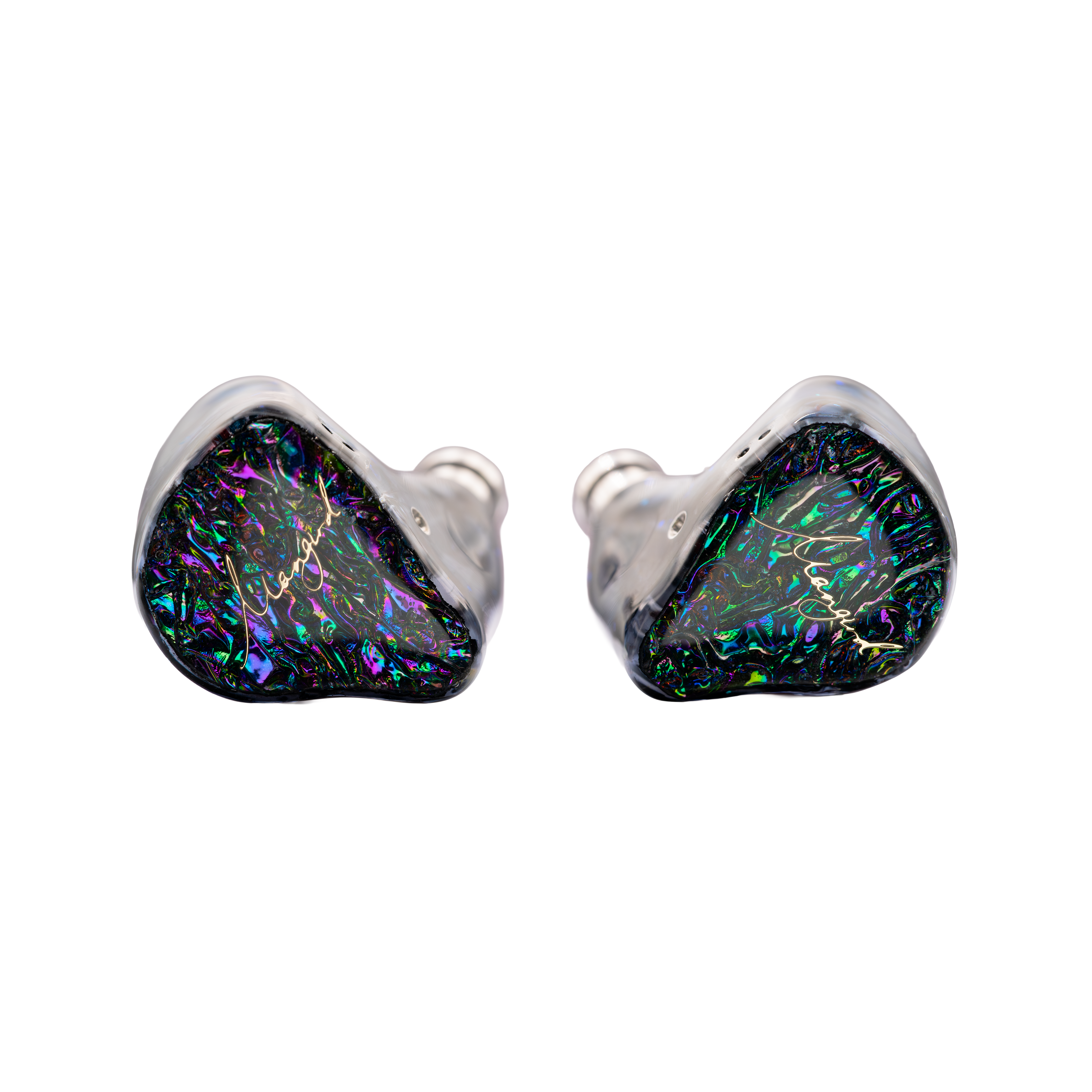

The only reason I was even trying those high levels is because the IEM were audibly quiter with the DX5 II vs even 70% volume on the the Mac.
With the IEM quieter compared to the laptop, I would start hearing distortion in the Xenns when connected to the DX5 II.
Having owned the A30Pro in the past (for a few years + multiple headphones like the HD800S, Arya Organic, etc.) I know what you guys mean by too much power causing audio distortion.
Which is why it was so weird for me to even understand what was happening ... and couldnt believe what I was hearing. As to why I was hearing distortion with the IEMs sounding so quite.
Even my 4 year old Quedelix 5K gets the IEM louder without any distortion.

I am not trying to play it at such dangerously loud levels. I am saying that I cant even hear anything on the IEM at -30db. Its dead quite. Almost equivalent to 5% volume when directly connected to my Mac.
The distortion is heard via the DX5 II at a volume level (again i dont have anything to measure this with) much lower than what i can easily (without distortion) drive the IEM to using my Mac alone.

At around at 75% mark (-0:17), when the bass comes in, the DX5II, at -35.5 db (USB, PCM 48khz, HPA SE, low gain, PEQ is disabled, and everything else is factory reset state, on latest f/w) is audibly distorting on my IEM.
Without changing anything else, I took the IEM out, connected it to the Mac 3.5mm jack, and no distortion is heard, even if i raise the volume to uncomfortable level (around 50% on the Mac)
