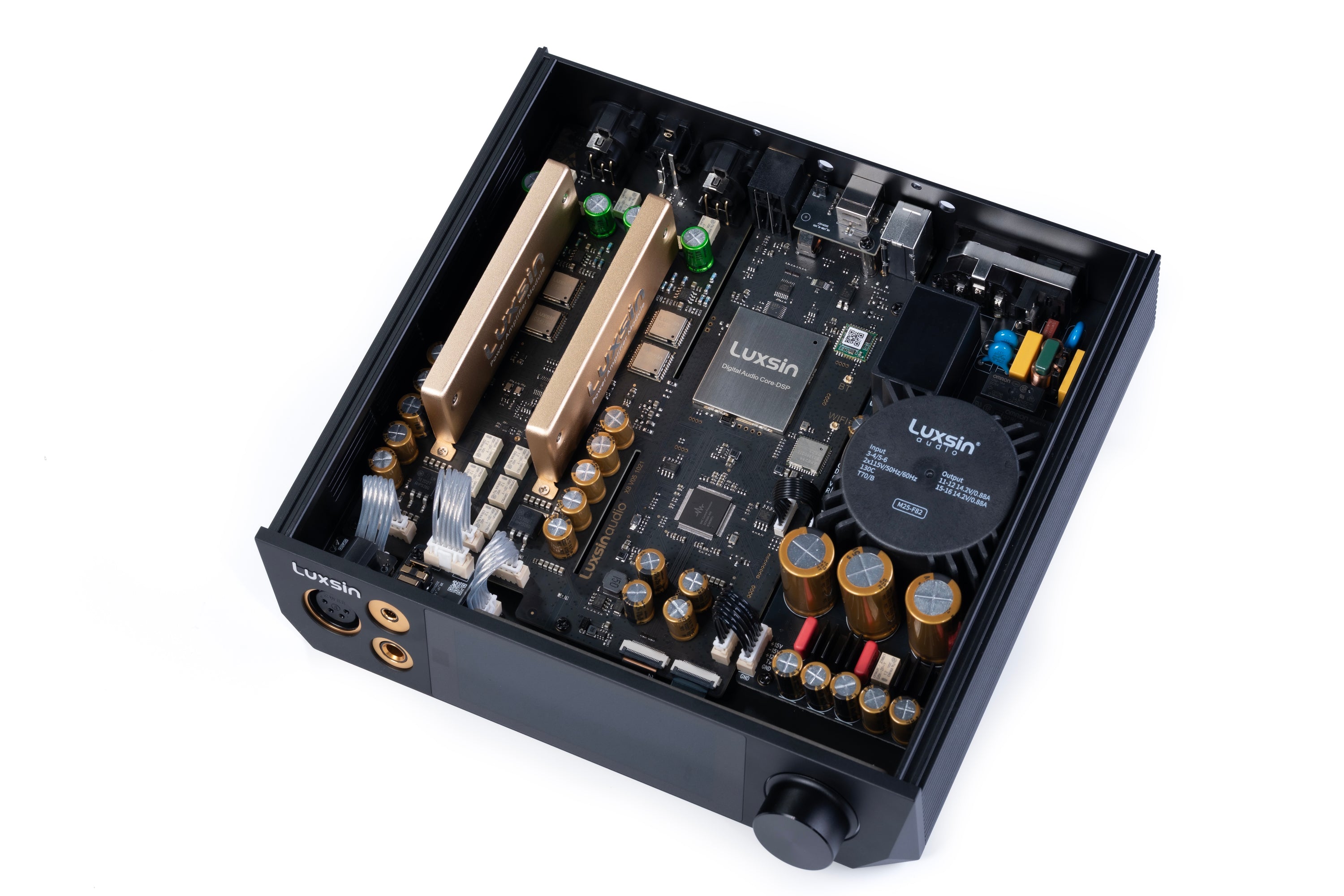

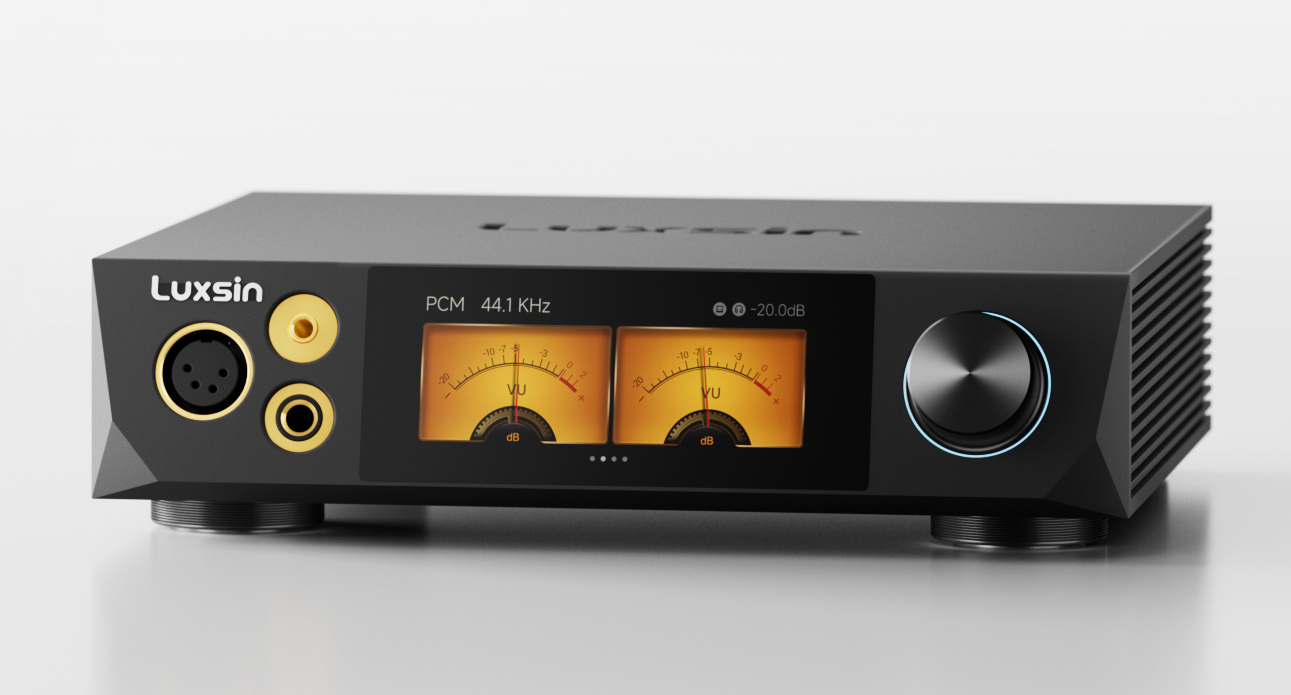

What are your thoughts on new the Luxsin X8? It appears to be a direct competitor to the DX5 II. I never tried the X9, but it seems to be a great device.
It seems to be a baby version of X9 :)
Retail price for X8 in Euro market is 699 EUR
What are your thoughts on the Luxsin X8? It appears to be a direct competitor to the DX5 II.
I have ordered the Luxsin X9 to replace my faulty Topping DX5 II.
I have asked several stores about the Luxsin X8, but they have no information on availability.
The Luxsin X9 was on sale, and I couldn't resist, as it was my first choice before I opted for the Topping DX5 II because of the price (big mistake).
I have had a look at the Luxsin X8, seems very interesting and several improvements over X9 in some respects and although it is double the cost of the DX5 II it is starting to look tempting if I do decide to return the DX5.
I understand they are an offshoot of Eversolo and I already have the DMP-A6 Streamer/DAC/HP Amp but firmware updates can be problematic (cure one but generate 2 new bugs) and the UI is very disjointed and can be confusing, but the main criticism I have is with the PEQ which can be very confusing and only has fixed frequency points. So I will need to see some intelligent reviews on the X5 and maybe the manual before taking the plunge.
