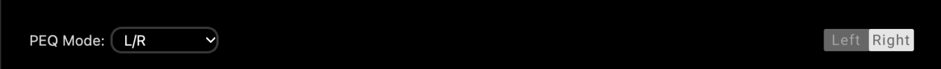

Can someone please confirm if I’m right? When it comes to headphones, we usually prefer the L+R configuration in Topping Tune if we want to EQ them. On the other hand, L/R is typically used for speakers, isn’t it?
I've got this pop up if I change to L+R
(Example Sundara EQ)
Correct.
L/R would be useful if you're aware of significant channel imbalance, either in your headphone or in your hearing.
One of my headphones is audibly quieter on one side, so I use this option to compensate for the volume.
Ok it makes sense. Thank you both of you.
