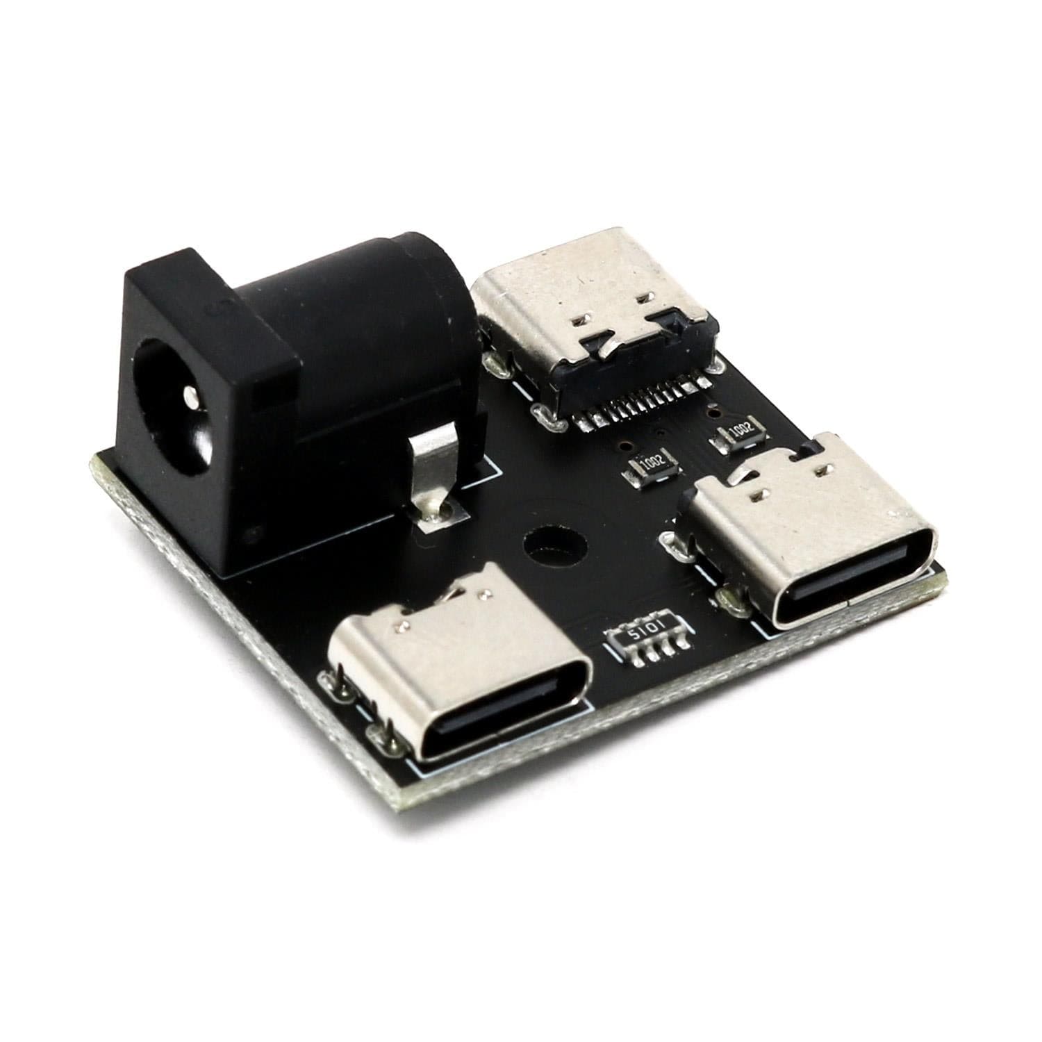

You can use this device with any usb source but you will need a USB splitter like this:
So the raspberry pi4 or pi5 can receive audio input by usb and also power (the usb c port for power is the only usb port which can acts like host).
