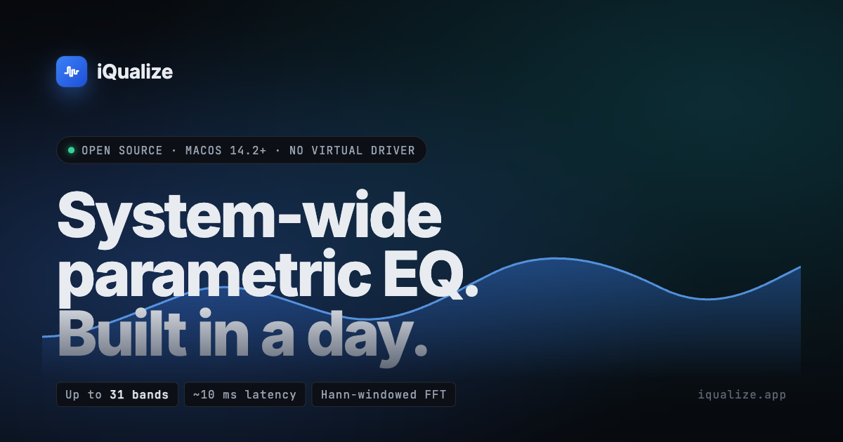

For my Mac I have found iQualize which covers my needs - that's where I use (as planned) the DX1 II, and I don't use it elsewhere. iQualize is in version 0.60 and as such not fully matured, but I have been able to get the sound I want from HD650, and it works fine with my bt buds too - to the extent it is possible to get something good out of them.
iQualize is native (swift) and doesn't require "kernel addons", it just taps into MacOS sound subsystem natively without the need for additional drivers. Although my security software doesn't ring a bell, I don't vouch for security and so on, but the code can be examined as it is opensource (MIT). Don't believe there's a need for manual intervention and cleanup when uninstalling contrary to a number of external apps for MacOS. Seems like the Bavarian developer is speaking the truth when he argues MacOS EQ done right.
The app is unsigned thus terminal and: xattr -dr com.apple.quarantine /Applications/iQualize.app
Have had to grant new permissions (system settings - Privacy & Security - Allow applications from) when updating.
I believe it deserves a slot in the ASR EQ hall of fame. Hopefully the competent ASR crowd will have a go at it and give it some love - or put my recommendation into shame.
