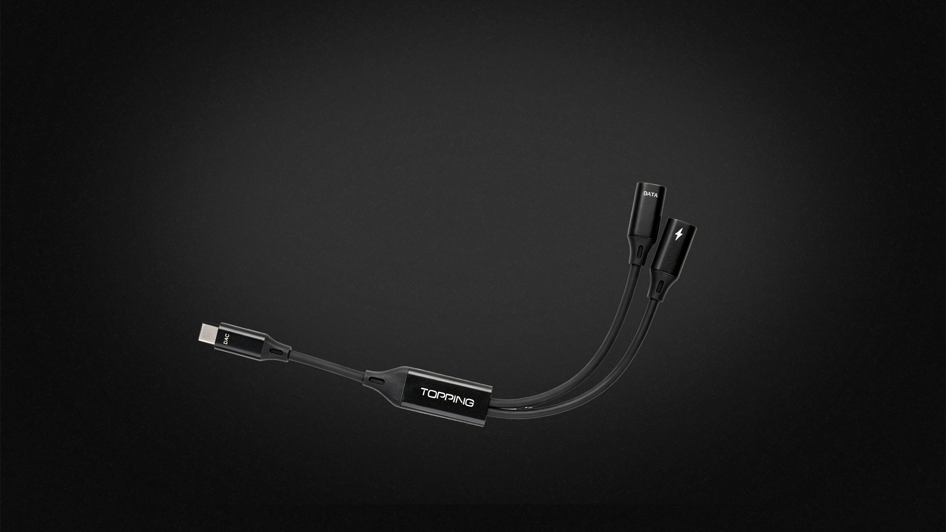

TOPPING TC-OTG-Y20
USB-C OTG cable with separate data and power lines, 22cm
