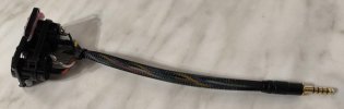

I'm using a 4.4Bal to 6.35(L/R) cable connected to my Pioneer DJ VM-50 speakers.
index.php
Or DIY. I had some leftovers from previous experiments, so I threw it together quickly. The measurements are very good, so I'm unlikely to replace it.View attachment 541374

Please excuse my ignorance. There’s only one line out socket for balanced out on the back. Don’t you need two for stereo (like the red and white RCA)?
It is a 5-pin TRRRS pentaconn connector so stereo balanced as well as stereo single ended all in a small 4.4mm diameter single jack plug.
Leaving L/R Cold disconnected and using only Hot as single-ended output usually has some unfortunate side effects like increased noise, distortion, and DC offset:
Not usually nor for all devices but is likely in this particular case as the RCA out is not optimal in the DX1.
Cheers, but if the extra noise and distortion were an issue, would they not have shown up in Amir’s measurements?
