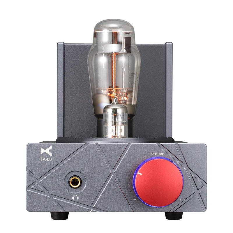

It's the present according to xDuoo.
So handsome, though...
