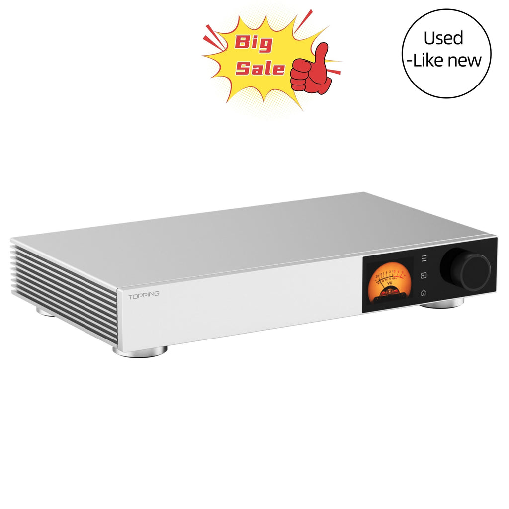

Topping's store has a selection of used-like-new D900s for $1309. For those in the US, they're shipping from a US warehouse. They come with a 1 year warranty and the 30 day return window still applies.
$1800 was a hard sell - $1300 is a much easier pill to swallow.
I received my used-but-new D900 today after it spent a few extra days in an Indiana USPS sorting facility as a vacation. It looked brand new; the display/dial still had the plastic protective film on it, the remote clearly had never been opened up for the battery installation, etc.
I had already removed my aging Bel Canto DAC 2.5 and RefLink, so this dropped right in with no real fuss. Plugged in the USB B cable coming out of my MusicPD server, patched in the AES XLR cable from the CD player and it "just worked". As one would expect, I couldn't hear a single difference between the DAC 2.5 and the D900 - with the exception of the volume control relays clicking. Those are fairly audible as you raise or lower the volume. Mute is a silent operation. The remote has some heft to it, and in my limited testing, works reliably and quickly. With the Buckeye 1ET6525SA amplifier gain set to low for both channels, I can only get to about -20db on the Topping volume control before my Thiel 2.4 SE's are uncomfortably loud!
Between the verified measurements of this unit, the two-in-one DAC/Preamplifier with hardware volume control, and the overall fit-and-finish of it, I'm pleased with it for $1300.
