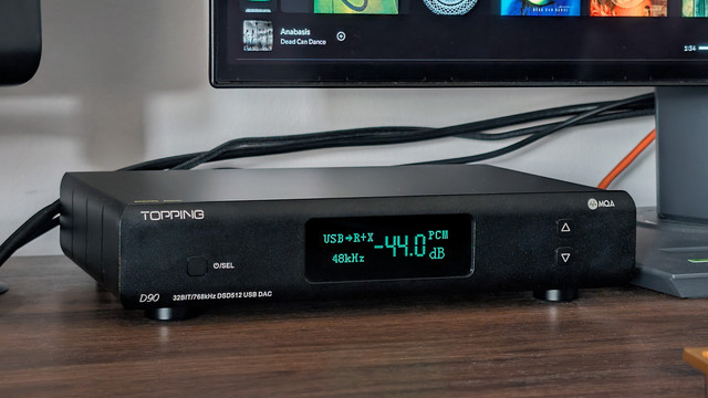

Been enjoying this DAC, have no complaints at all other than the display... Not a huge fan of the white text so I ordered a sample pack of Selens lighting filters, going to install one in front of the OLED, just need to decide on a colour first...
I'm leaning towards amber or turquoise, both reminiscent of late 80s early 90s hifi... The amber being heavily used by Yamaha and the turquoise by Marantz :D
What's your pick?

As previously mentioned I'd narrowed it down to two colours, either Yamaha style orange or Marantz aqua... I lived with both for several days before deciding, leaving the film leaning against the DAC as pictured above.
Just as laserjock said, the orange is better nearfield and the aqua distant... I suppose that's why plane cockpit and car dash instrument panels are mostly orange. Only thing is I like to have the display set at the lowest brightness (less of a distraction and preserves the OLED a little longer) and at this low level the orange didn't have enough clarity requiring a proper look rather than a cursory glance so for convenience aqua wins :)
