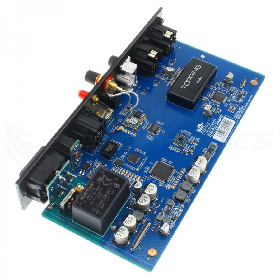

I was comparing pictures of the PCBs of the D70S and the D70 Pro. I noticed that the D70 Pro uses switching power supplies instead of the linear power supply in the older units. This is a interesting choice, given common audiophile wisdom is that the latter is superior. Also it seems the D70 Pro does not contain the FPGA and also the femtosecond clocks found on the previous version. I was wondering if someone more knowledgeable than me can comment on these changes.
It's worth updating your knowledge of the current state of the art in Switching PSUs.
Check out this article as an easy start point - https://benchmarkmedia.com/blogs/ap...audio-myth-switching-power-supplies-are-noisy

I don't claim to be especially knowledgable, but there is the big difference between these models is the make of DAC-chip. AKM for de D70s and ESS for the D70Pro (sabre). It is my understanding that, certainly flagship-ESS-chips have more components, like clocks, integrated on the chip itself. Also maybe reason why the FPGA is no longer implemented. Anybody more knowledgable, please comment/correct:)
As for the Linear/switching PS debate: I think it is clear by now that in low-power applications, a good quality, well-implemented SMPS has no downsides compared to a linear PSU. Quite the contrary. A DAC is not a power-device. If the switching frequency is wisely chosen, and the the filtering is of high quality (which is relatively easy for this kind of low-power apllications) I have no issue with the use of SMPS. And nobody should.
On PSU's: I have the Audiophonics (the wholelottalettersandnumbers model name, yep that one) Purifi Stereo power-amp of course with an SMPS. I know it is a good design, made for Class D modules (specifically designed for HYPEX units I presume, but perfectly suitable for the Purifi's too). Still I can't help but wondering: what would this amp sound like wtih a big, heavy, Linear (toroidal or other) PSU in it? It would not be a simple swap. But still: I wonder. Sometimes. Not for long. I got an Elac Alchemy Series DPA-2 on loan from a neighbour. It has Hypex modules powered by SMPS, but a discrete buffer-section with it's own seperaate linear power-supply. The Elac is like slightly punchier, denser sounding. For the first five minutes. Listening any longer I can't tell the difference.

Thanks for the insights folks. I did not know that about switching power supplies. Yes I do wonder if there is an integrated clock generator in the ESS PRO chip. I'm assuming this version is also cheaper to build as well for Topping as well in regards to raw component costs.
