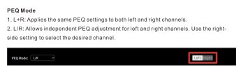

FoA, congrats to Amir and the rest of you for this knowledge place. I have been reading you for a while, although have some background on computer science, I am an amateur in the analog/sound domain, so learning a lot from your posts and videos...
I just got this little engineering gem, and did not have the chance to get my hands on a windows box to check, but regarding the shared PEQ for both channels, I came across this (attached) in the manual from topping, which might suggest it is now applicable to either channel or both. Can anyone confirm? I this feature just for bigger brothers (D90)?

I don't recall seeing that in Topping Tune last time I booted. It might be something that is only on their higher-priced models for right now. The DX5 II that is about to release sometime this month (apparently) might have that functionality?

Yesterday, I loaded up Topping Tune (v1.04), and I did not see that option anywhere. In what manual did you see that?
Hi,
I got to downloads:
Then dowloaded topping tune reference guide:
On page 6 of the English versión, when discussing "Chart Section" it can be found.

Huh...
I will have to double check on my home computer when I get home because when I checked and posted the follow up, I didn't see it (but my eyes notoriously skip over things). Checking just a moment ago on the computer I use at work shows a dropdown menu above the main graph window (top left corner).
I will check to see if that dropdown menu disappears if it sees my D50 III DAC connected. There is no external DAC on the computer at work.

Unfortunately it seems D50 III doesn't support this function.
That might explain why I didn't see the option the other day when I checked at home, but it's there on my work computer with no Topping DAC connected.

Just got home, and booted up Topping Tune in VMWare Fusion - The "PEQ Mode" option was there when the app initially booted, but disappeared almost immediately.
