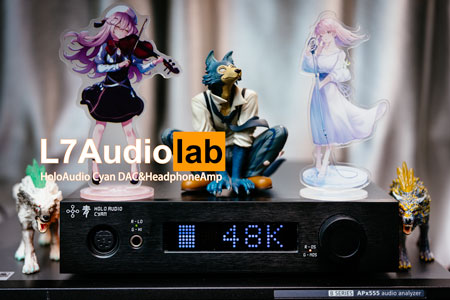

Well, what do you know - it's not quite as good as the Centaurus. The Cyan 2 is rather better though, and is probably similar to the Topping.
That’s the original cyan from a number of years ago. Not the cyan 2 that launched in late 2023
