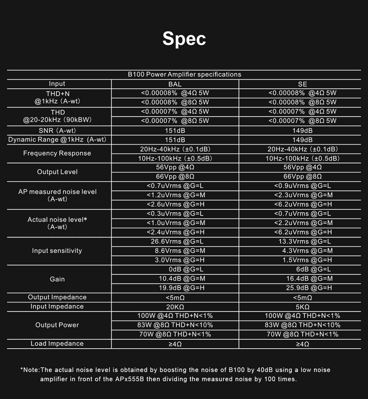

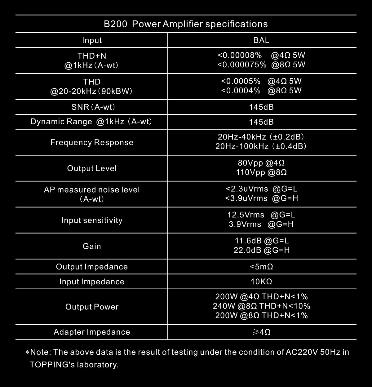

If the noise from the PSU was as bad as you are suggesting then it would show in the noise measurement of the amp.
<2.3 uVrms at low gain.
Thats including the noise from the Audio Precision analyser !!!!
If less than 2.3 microvolts is still too high for you, do what I did and buy B100 with actual noise of less than 0.3 microvolts on low gain.
See the note on how actual noise is measured, and how the Audio Precision analyser gives a false reading from including it's own self noise.

Audio Precision claim that the self noise of the APx555 is less than 1 uVrms, this is obviously represented on this spike coupled to the noise of the B200.
Using Toppings data for the B100 it shows Audio Precision measured noise as <0.7uVrms whereas the actual measured noise, measured in the way that Integrated Circuits are measured, is <0.3uVrms.
So the noise spike is much higher than actually exists.
At the end of the day, it's testimony to the engineering of Topping that their devices are measuring at the limits of available testing equipment costing $ 50,000 plus.
