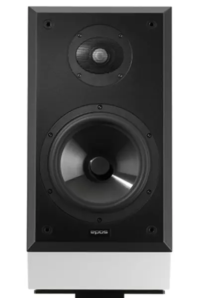

Passive Speakers:
Try the new audio first fidelia or the Ascend Acoustics Sierra LX or, if you are rich, the Epos ES 14 N
