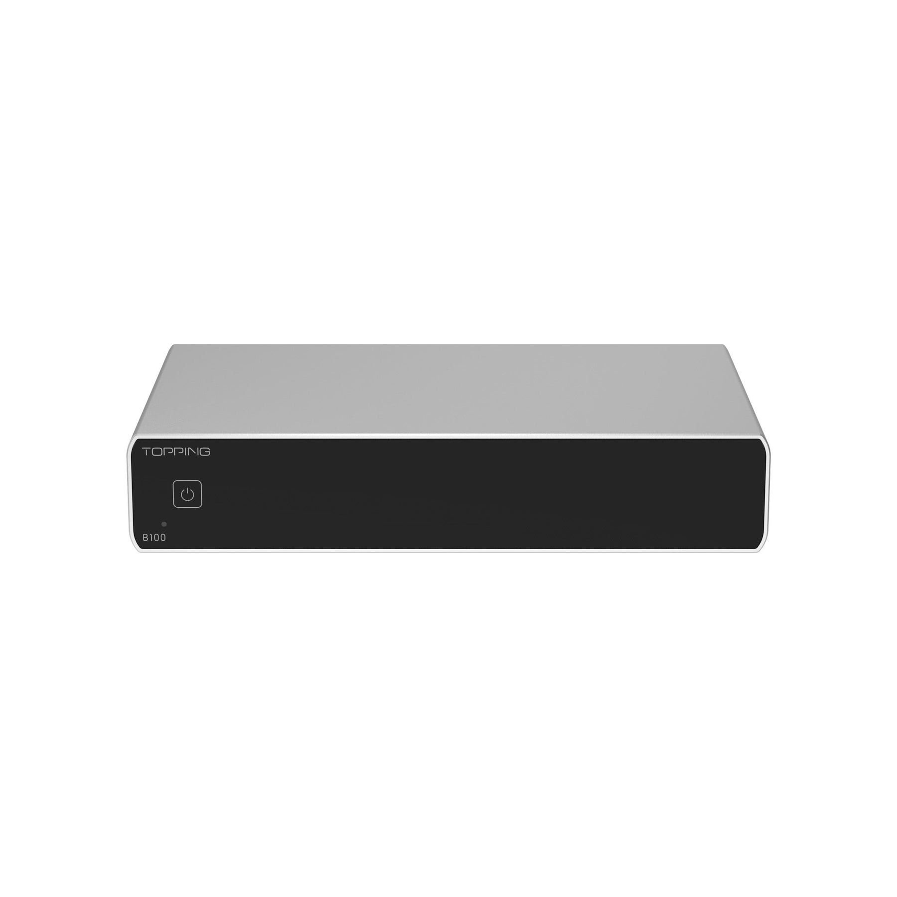

This is a review and detailed measurements of the Topping B100 "monoblock" amplifier. It was sent to me by the company and costs US $299.
I was surprised by the desktop/low profile of the amplifier. I expected something a lot taller/chunkier especially since this is a class B amplifier and not class D. Power supply is of course external:
Nice to see balanced input, three gain settings and trigger input.
The front panel power button is touch sensitive. You have to learn to just touch and remove your finger for it to power on. When it goes into protection, you have to hold it until error codes disappear and then touch again for powering up.

Conclusions
Topping is clearly its own competition, constantly pushing the envelop in noise and distortion. Even when you get used to them delivering on these fronts, they come up with this amplifier where test after test shows excellence in engineering and utmost dedication to highest levels of fidelity. All of this comes in a compact enclosure with a reasonable cost. I have no choice but to bow to their mission and abilities.
It is my absolute pleasure to recommend the Topping B100 monolock amplifier.
