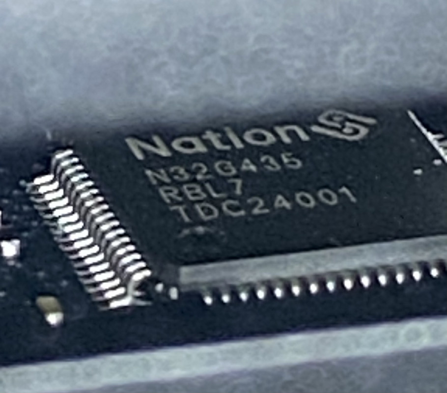

The USB-C port is probably used for programming the following microcontroller:
https://www.nationstech.com/en/N32G435IC/
HEHEHEH thank you for posting actually is very interesting would be great to have more HD pics internals and better a teAR down but perhaps manufacturer doesnt allow.... any way this picture, im not engineer or technician but yeah heheheh it doesnt look very "100% discreet amp" right ? happy new year to all!!!

I relieve the mystery or sort of. Firstly it's not a chip amp for sure. This amp uses 8 LFPAK56/SOT669 transistors in bridge. They're probably PHPT6*** series from NXP (my guess). There aren't much manufacturer whom use this package. Also it can be a pair in one package. No markings since they removed it (typical) and I'm not gonna characterise it until one of my unit fails.
On the input stage they used OP1656/OPA1612. No surprise here. What under the small pcb still a question mark but it has at least one chip with SON-8 package probably a 1612 again?
One more interesting thing the Nation controller uses an 4Mbit external flash so reviving a stuck unit may be possible with a simple manual reflash.
That MCU has also 128kB flash and supports encryption.
