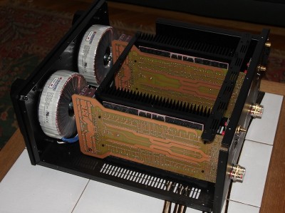

I consider the mono configuration only for practical reasons because my front door and the passage is between the speakers and also for aesthetic reasons because my speakers being wide and raised 22cm they will be under the speakers. if not, I do not think there is a difference with a true double mono as for example the ATI 6002.
image_preview2
