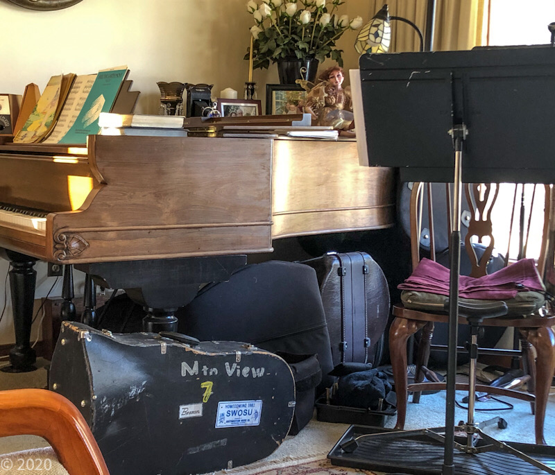

This is all I have that's accessible at the moment:
It's terribly messy around where I practice the tuba, especially when several of the instruments that normally rest in the basement are up for exercise. I can fit three tubas in their cases under the piano. I call it acoustic room treatment. That side of the piano is the only first-reflective surface there is between my Revel F12's and the listening position.
The case shape was a standard shape for the Hazelton Brothers maker back before they were bought by a large upright-piano maker during the upright piano boom. That occurred in 1896 give or take a year. This piano was made in 1885. The only hint that it is a Victorian-era piano is the sharp corner where the side turns to the bend. Hazelton Brothers was a small and fairly obscure piano maker in New York that was reasonably well-known and respected. It was a solid maker but not in the class of Steinway or the major German/Austrian makers of the day. I bought it from a very old church in Fort Worth 32 years ago--they had used it since new but had received a gift of a Yamaha Conservatory Grade concert grand and this one became surplus to their needs. I refinished it, made repairs, painted the legs black (in Victorian style), and went through the action (which I need to do again). The action is pretty loose--any classical pianist would think it imprecise and a bit sluggish with a slow repeat compared to a modern Renner action. But it is pretty easy to pull the action and work on it. The soundboard is not perfect but it sounds pretty good. It certainly does not sound like an "old" piano. It's 76" and a pretty good size for a normal-sized house. It is NOT to be confused with a modern-era furniture-grade piano.
Come to think of it, I have a picture of it with my collection of tubas from about 25 years ago (the collection is entirely different now except for the second tuba from the left, which I still have--all the other have gone on to new homes). This photo was my previous house, right after I moved to Virginia. That house was bigger in spots, and I took over the dining room for housing the piano.
Rick "yes, the wife cast a greedy eye on the top of the piano, but it's good for pianos to leave the lid down anyway, in spite of interior designer tastes" Denney
The wood finish on that side panel looks beautiful !
You could have fooled me LOL
It was a solid maker but not in the class of Steinway or the major German/Austrian makers of the day. I bought it from a very old church in Fort Worth 32 years ago--they had used it since new but had received a gift of a Yamaha Conservatory Grade concert grand and this one became surplus to their needs. I refinished it, made repairs, painted the legs black (in Victorian style), and went through the action (which I need to do again). The action is pretty loose--any classical pianist would think it imprecise compared to a modern Renner action. But it is pretty easy to pull the action and work on it. The soundboard is not perfect but it sounds pretty good. It certainly does not sound like an "old" piano. It's 76" and a pretty good size for a normal-sized house.
I find it amazing that instruments this old are still around and playing. A lot of LOVE must have went into the original builds.
Enjoy them both guys, that to me is incredible !!!
