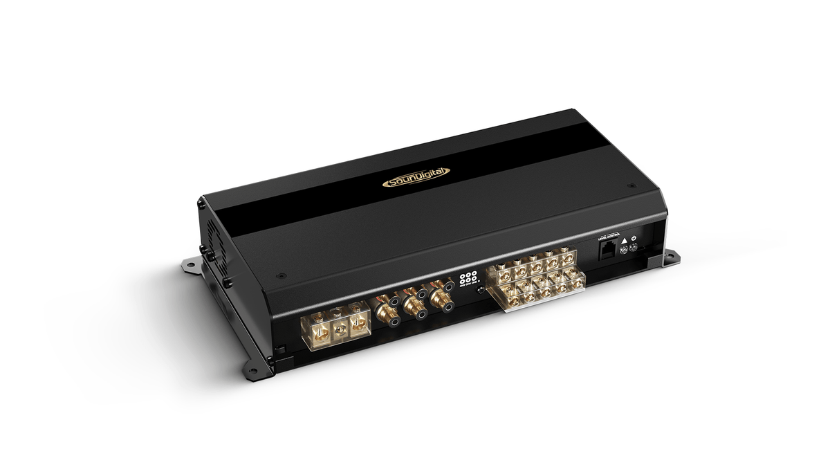

Anyone in the US willing to buy and send one of these for review? 5 channels, 1.1k usd.
