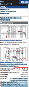

With KEF R series is the one to get. Others arent that great. Navis is good, but it can be easily beaten by a KEF R7 costing 75 percent of its price. There is nothing wrong in pointing facts I think. See the distortion is high. if BrokenGuy had never showed me what to look for, I would have overlooked this spec on every speaker. Thanks to him. Most speakers fails in terms of distortion here, and thats the place were KEF R series really has an edge here.
