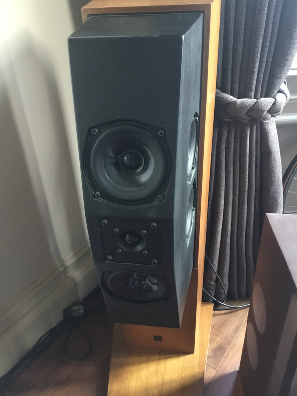

Meridian M1 from around 1978, advanced for the time, active, they were really expensive, amps in the base which could slide out.
There were many versions presumably because Meridian were using whatever was around at the time.
I bought their M2 a year or so later and eventually the M10.
I can’t help but have exceedingly fond memories of those designs and would probably get a pair if they ever decided to re-make them with contemporary bits.
I part exchanged a pair of M10 against the customer’s M10s and kept them until a higher authority decided we had too many speakers!
Another speaker I ( in an ideal world) would have kept a really beautiful pair of rosewood M2’s.

I remember being very impressed with these but they were out of my range at the time. What strikes me now are the resemblances to the KEF Blades.
