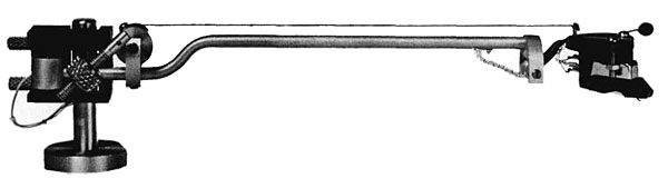

Given the type of discussion here I suspect someone might get a kick out of this old Stereophile review of the “unique” Transcriptors Vestigal Tonearm.
J. Gordon Holt certainly doesn’t hold back with the many criticisms. And there is some spicy back-and-forth with manufacture, examining the technical claims:
