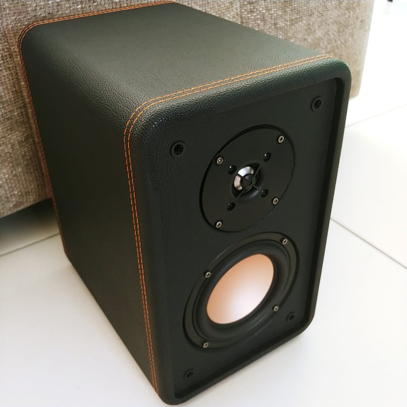

I originally set out to build the speaker cabinets out of bamboo (to honor my Bamboo project). But due to lack of time and resources, I ultimately opted for a pair of 20mm high-density MDF pre-assembled cabinets with a leather-like black cover, the volume is similar to the stock cabinets with rounded corners to avoid diffraction.

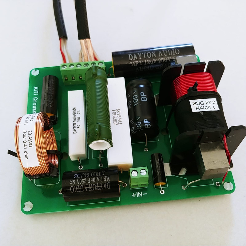

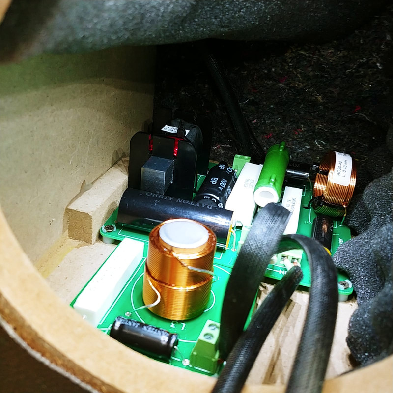

I used 2.5mm² copper cables for the woofers and 1.5mm² for the tweeters. I also paid particular attention to sound insulation by opting for three different materials: a 12mm Vibrofiltr Felt acoustic panel with a cork backing to absorb vibrations, and high-density acoustic foam for the upper of the speakers.
The crossover is covered with a high-density wool sheet made of 85% cotton and 15% polyester with a density of 600g/m2

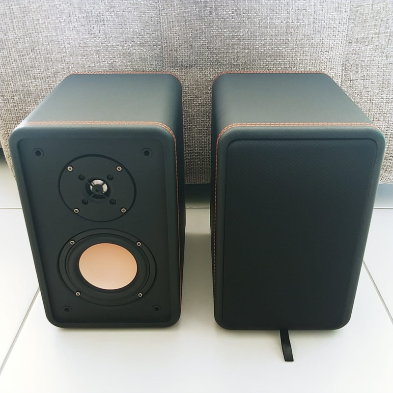

Nice build, but...
How exactly did you design the grille frame? There is a reason why loudspeakers have not been using recessed baffles since the 1970s, including the AlTi design. I won't be surprised if yours have some surprises in store in the low/mid treble in particular when measured.

I'm not sure if my English is correct but the speaker grilles are quite aesthetic here, I don't use them at all
Generally speaking, I remove them from all my speakers)

They meant this lip here: (bottom right orange dotted lines)
Nice project! It seems that you've done some good work on this crossover and they look really cool/unique.

He has the measurements above. I also thought that there would be some problems with diffraction on these edges but he seems to have worked it into the crossover well. There is a dip in the 3-4Khz range and another at 5.5Khz, but they are well within the acceptable range.
Compliments go to Matt Grant who designed the speakers. I just opted for a few more high-end components on the crossover compared to the original project.
