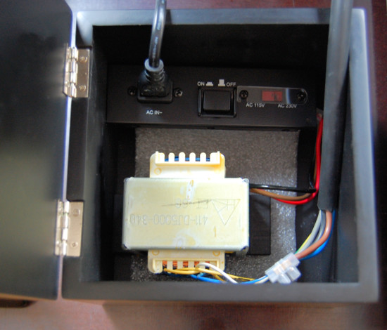

That's very true. A significant improvement. But then again, if it was a problem, anyone could remove and remotely mount the conventional power supply and run an umbilical.
Yes, that was, for example, one of the measures to improve a previous Hanpin DD I once had. I placed the transformer in an external box.
