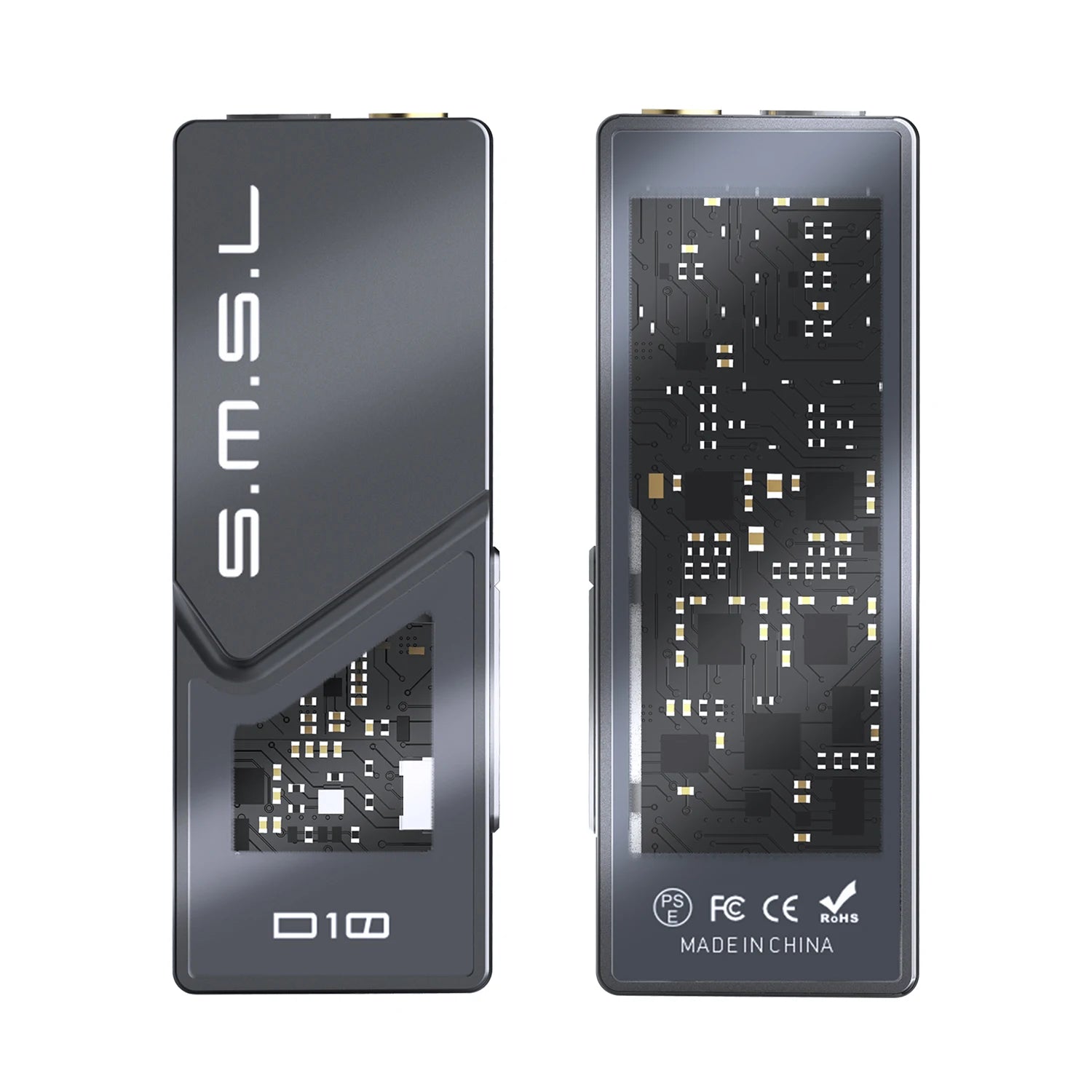

Reporting back on S.M.S.L D10
In my opinion, looks nice, looks the part, but it is CRAP!
First and foremost, it sounds crap! (with my LCD-XC). no amount of EQing does any good, I think the one I got was faulty, didn't last 15 minutes (Edit: before I decided to send it back).
It was a bright, distorted sound, that also clipped & compressed badly if pushed. It had more power on balanced, which incidentally, I had to make a new cable for it.
But more power, with the same distortions and brightness of single ended. Maybe it just doesn't like my headphone's impedance of 20R.
I was looking forward to testing the device, see how much actual power it had, but very quickly, I repackage it to send it back.
Last point! - I did try an Apple dongle in the past. I can not recall it sounding bad, it just had no power. My Huawei phone sounds superior to D10, but again, no power.

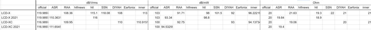

uhm, and indeed it seems i completely missed the math... wrong calculator... the LCD-XC should be pretty efficient, at 100 db/mW 20R it is 117 dbV and should need no more than 70 mV to get 94 db (220 mV for 104 dB)
so every dongle should be more than enough even with SE output.
Amir measured LCD-X at 150 mv for 94 dB that should be around 93 db/mW @ 20R instead of rated 103 db/mW so LCD-XC could also actually be less sensitive, but not challenging.
Anyway nothing of this can be related to the sound issue you perceived, and if the dongle have some kind of flaw even power considerations can't be done.
Here are the numbers:
