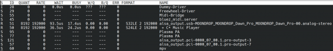

+- the same behavior with Moondrop Dawn Pro(CT7601+CS43131), it cuts the first part of anything above 96000Hz.
16/24/32 bit up to 96000Hz works, anything above does not.
Just for reference, i do not have this issue on my Linux Box.
The highest i have is 192kHz and it plays like every other file.
(Pipewire, the processing engine above the sound system on Linux, does everything 32bit float internally, that is why it shows S32LE but the original song is, as you see in the line below, 24bit. But i noticed no difference between 16, 24 and 32bit).
I created a very short test file and if i play it, it instantly plays, without any delay or whatever. There is no cut of the first few ms.
So if that helps, it is an Windows related issue and probably able to be solved in Software.
