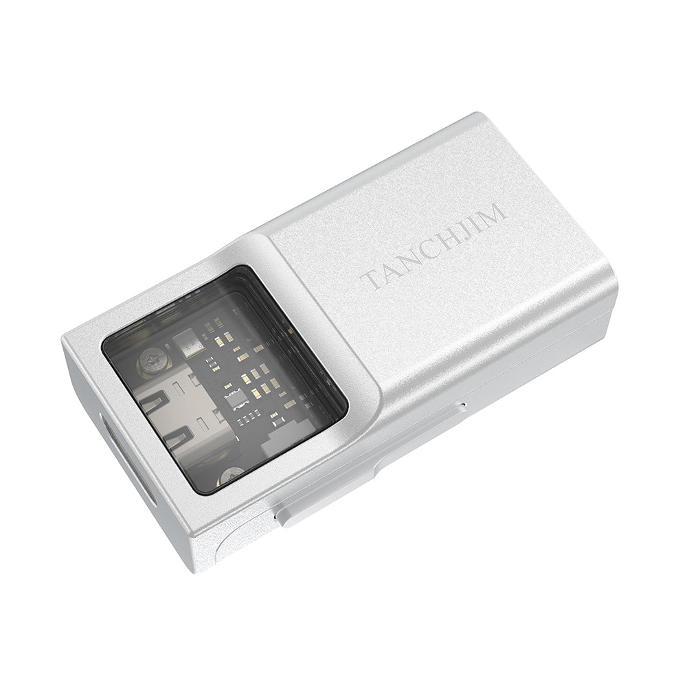

This is a review, listening test and detailed measurements of the TANCHJIM Space portable DAC and balanced headphone adapter. It was sent to me by the company and costs US $90.
I like the transparent window so that you can see the insides. There is an LED that lights up there when you reach the maximum volume control using the toggle buttons on the side. Speaking of those, they are some of the nicest ones I have used with very nice feel and action. You have the option of using 3.5 and 4.5mm headphone plugs. A neat, dual cable USB-C cable is provided as you see in the picture.
