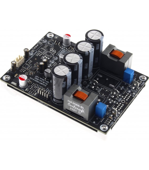

It seems to me that you are announcing around 106db to 108db Sinad @5W/4R for the FB100 with a gain of 14db (5V/V). It is finally very close to the 3E Audio 260-2-29A (TPA3255) module with a gain of 16.5db (stock = 20.5db) which displays more than 105dd Sinad@5W/4R.
What would be the major benefit of moving from a TPA3255 module to a much less powerful TPA3251 module?

I have recently experimented with my FB360 using 36V and a 52V DC supply; and using a lower voltage supply only reduced the noise floor by 1.5dB. The harmonics were slightly different, but the overall THD more or less remained the same.
The major benefit would be the output power. Using a 51V supply, the 3e stereo version only reaches 144W at the knee of clipping. If you reduce its power supply to 34V, then I believe the clipping point will decrease to around 60W at 4ohm (probably even lower, you can observe the clipping point when the red clipping indicator is faintly pulsing).
The FB100 can get 100W @4ohm using a 38V supply. (I think the 3e stereo's clipping point will be around 80W with 38V supply). The PFFB design of TPA325x will alter the clipping point profile, that's why I've abandoned designing a stereo single chip TPA3255 PFFB. This isn't the case for non-PFFB TPA325x designs, where it should have the same clipping point when given a specific voltage supply (assuming all else are equal).
Not promoting the TPA3251, but it has a slightly clearer midrange, and finer highs. What's good about TPA3255 though is that it has a fatter midrange sound, making it suitable as a bass/mid amp for a bi-amp system.
