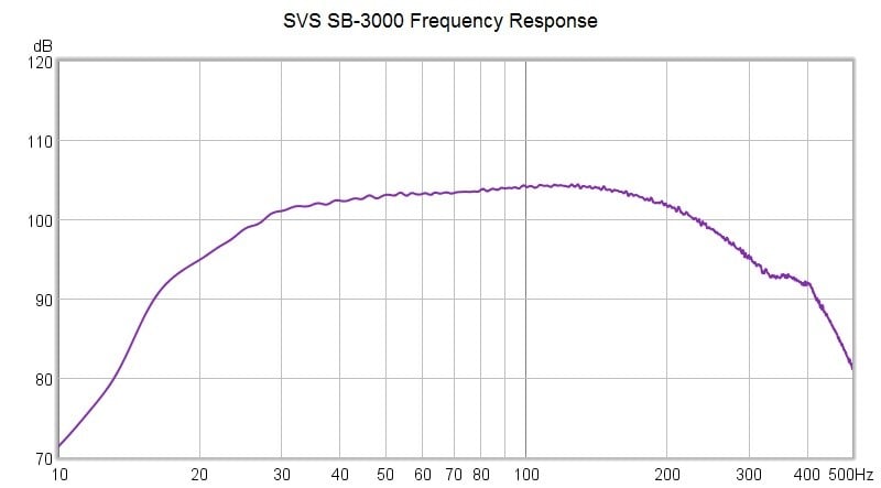

I, too, appreciate Erin's diligence but I hope we can get to the bottom of the discrepancy.
It takes a large 15" driver vented sub like the Rythmik FV15HP to do 107 dB at 20 Hz, so something isn't right.
I hope no one buys these assuming they are going to get that kind of output in a small sealed cube. They will be disappointed.
I think it's more around 93...94 dB @20Hz if I check Erin and Audioholics measurements, right?
Erin's measurements
Audioholics's measurements
Indeed, the CEA-2010 measurements look differently:
Maybe Erin can provide a better answer, as I feel like the way we interpret these measurements is not clear enough. Thanks!
