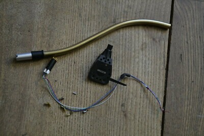

Hey all I bought a Ortofon 2M BRONZE the old Stanton actually fell into pieces when removed it held on for dear life .
And one the litz wires where broken off from the connector previous owner had just fit the wire between the pickup pin and the connector .
Which prompted me to buy a simple solder station and a soldering "stand/fixture thing" with built in magnifying glass , i gladly outsource this someone else next time , last time i did this 30 years ago i had no problem seeing the darn things ... :)
But note of caution the 2M is rather large it barely fits inside the shell of the older version off series III armwand , so i had to press it into place .
So now I'm after the modified arm wand ? found most other spares online but no extra arm wands ?
