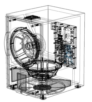

Here is the Perlisten Push/Pull:
image_preview2
This is the SVS 3000 Micro (dual opposed):
Though similar, the two are fundamentally very different.
