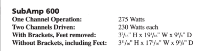

The SubAmp 600 only puts out 275W into a single subwoofer:
